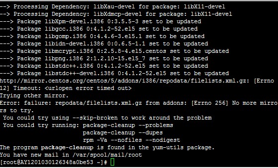

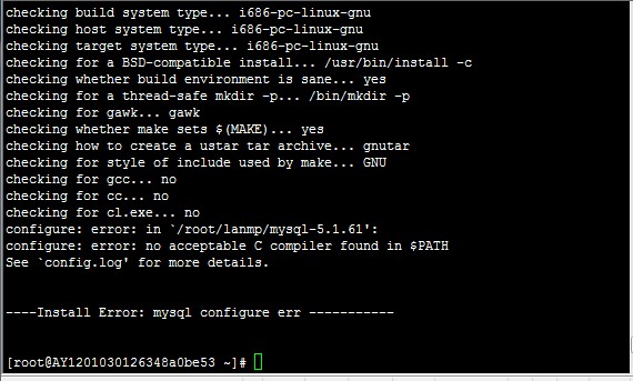

全新安裝的時(shí)候,install Error :mysql configure errr
然后在下面鍵入
  1. yum install -y gcc gcc-c++ make autoconf libtool-ltdl-devel gd-devel freetype-devel libxml2-devel libjpeg-devel libpng-devel openssl-devel curl-devel patch libmcrypt-devel libmhash-devel ncurses-devel sudo bzip2
復(fù)制代碼
然后出現(xiàn)
  1. ---> Package libstdc++-devel.i386 0:4.1.2-52.el5 set to be updated
  2. http://mirror.centos.org/centos/5/addons/i386/repodata/filelists.xml.gz: [Errno 12] Timeout: <urlopen error timed out>
  3. Trying other mirror.
  4. Error: failure: repodata/filelists.xml.gz from addons: [Errno 256] No more mirrors to try.
  5. You could try using --skip-broken to work around the problem
  6. You could try running: package-cleanup --problems
  7. package-cleanup --dupes
  8. rpm -Va --nofiles --nodigest
  9. The program package-cleanup is found in the yum-utils package.
  10. You have new mail in /var/spool/mail/root
復(fù)制代碼
重新安裝還是出現(xiàn)最面的那個(gè)錯(cuò)誤,install Error :mysql configure errr,也把
  1. 登陸SSH,編輯下:/etc/yum/pluginconf.d/fastestmirror.conf
  2. vi /etc/yum/pluginconf.d/fastestmirror.conf
  3.   把enabled=1改成enabled=0
  4. [main]
  5. enabled=0
  6. verbose=0
  7. socket_timeout=3
  8. hostfilepath=/var/cache/yum/timedhosts.txt
  9. maxhostfileage=10
  10. maxthreads=15
  11. #exclude=.gov, facebook
復(fù)制代碼
這個(gè)做了

本帖最后由 阿飛劉 于 2012-3-11 16:17 編輯
  1. ---> Package libXpm-devel.i386 0:3.5.5-3 set to be updated
  2. ---> Package libgcc.i386 0:4.1.2-52.el5 set to be updated
  3. ---> Package libgomp.i386 0:4.4.6-3.el5.1 set to be updated
  4. ---> Package libidn-devel.i386 0:0.6.5-1.1 set to be updated
  5. ---> Package libmcrypt.i386 0:2.5.8-4.el5.centos set to be updated
  6. ---> Package libpng.i386 2:1.2.10-15.el5_7 set to be updated
  7. ---> Package libstdc++.i386 0:4.1.2-52.el5 set to be updated
  8. ---> Package libstdc++-devel.i386 0:4.1.2-52.el5 set to be updated
  9. addons/filelists                                         |  180 B     00:00
  10. http://mirror.centos.org/centos/5/addons/i386/repodata/filelists.xml.gz: [Errno -1] Metadata file does not match checksum
  11. Trying other mirror.
  12. Error: failure: repodata/filelists.xml.gz from addons: [Errno 256] No more mirrors to try.
  13. You could try using --skip-broken to work around the problem
  14. You could try running: package-cleanup --problems
  15.                         package-cleanup --dupes
  16.                         rpm -Va --nofiles --nodigest
  17. The program package-cleanup is found in the yum-utils package.
  18. 11 Mar 16:11:12 ntpdate[2330]: the NTP socket is in use, exiting
  19. setenforce: SELinux is disabled
  20. Stopping httpd:                                            [FAILED]
  21. mysqld: unrecognized service
  22. error reading information on service mysqld: No such file or directory
  23. installing mysql...
  24. checking build system type... i686-pc-linux-gnu
  25. checking host system type... i686-pc-linux-gnu
  26. checking target system type... i686-pc-linux-gnu
  27. checking for a BSD-compatible install... /usr/bin/install -c
  28. checking whether build environment is sane... yes
  29. checking for a thread-safe mkdir -p... /bin/mkdir -p
  30. checking for gawk... gawk
  31. checking whether make sets $(MAKE)... yes
  32. checking how to create a ustar tar archive... gnutar
  33. checking for style of include used by make... GNU
  34. checking for gcc... no
  35. checking for cc... no
  36. checking for cl.exe... no
  37. configure: error: in `/root/lanmp/mysql-5.1.61':
  38. configure: error: no acceptable C compiler found in $PATH
  39. See `config.log' for more details.
  40. ----Install Error: mysql configure err -----------
  41. PING www.szkyjg.com (113.105.167.213) 56(84) bytes of data.
  42. From ip223.hichina.com (223.4.31.251) icmp_seq=1 Time to live exceeded
  43. --- www.szkyjg.com ping statistics ---

  141. checking host system type... i686-pc-linux-gnu
  142. checking target system type... i686-pc-linux-gnu
  143. checking for a BSD-compatible install... /usr/bin/install -c
  144. checking whether build environment is sane... yes
  145. checking for a thread-safe mkdir -p... /bin/mkdir -p
  146. checking for gawk... gawk
  147. checking whether make sets $(MAKE)... yes
  148. checking how to create a ustar tar archive... gnutar
  149. checking for style of include used by make... GNU
  150. checking for gcc... no
  151. checking for cc... no
  152. checking for cl.exe... no
  153. configure: error: in `/root/lanmp/mysql-5.1.61':
  154. configure: error: no acceptable C compiler found in $PATH
  155. See `config.log' for more details.
  156. ----Install Error: mysql configure err -----------
復(fù)制代碼
作者: admin    時(shí)間: 2012-3-11 18:18
DNS錯(cuò)誤,域名解釋不了
所以
這個(gè)也沒更新成功
作者: 阿飛劉    時(shí)間: 2012-3-11 19:39
那怎么解決
作者: admin    時(shí)間: 2012-3-11 22:35
換一個(gè)DNS
作者: 阿飛劉    時(shí)間: 2012-3-12 08:04
換虛擬主機(jī)的dns?
作者: 小蛋    時(shí)間: 2012-3-13 12:04
我有一臺5.4的也是這個(gè)問題。不理解咋 回事
作者: admin    時(shí)間: 2012-3-13 12:48
DNS不行,所以域名解析不了,所以yum更新不成功,所以沒有相關(guān)的依懶包和庫,所以安裝不成功
可以換一個(gè)DNS試試,可以看/etc/resolv.conf這個(gè)文件
