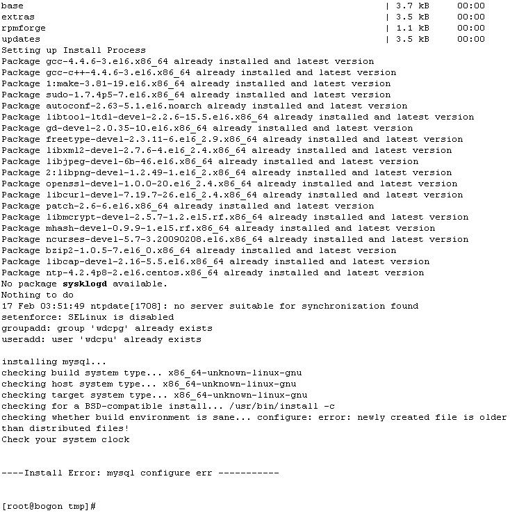

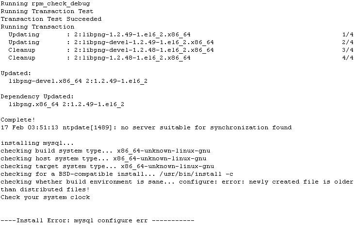

(bio)}: [] sh in.shbr(sh)(bo)Install Error: mysql configure err ȣ [ӡ]
: itxsy    r(sh)g: 2012-4-26 19:51     (bio)}: sh in.shbr(sh)(bo)Install Error: mysql configure err ȣ
W(wng)ѵƆ}http://www.szkyjg.com/bbs/thread-953-1-1.html
f һپg
Ҿ
жdb
sh in.sh un
жdԄ(dng)
(dng)䛺ٴ\(yn)
sh in.sh
b
ԇ˛]á
ϴʲôϵy(tng)͛]˸ԵÑҕQ
ҵCentOS 6.0ǏFW(wng)վµisoļ wdlinux_base_64_6.iso
Ո(qng)ϴQ}ѽx
؈D
ba
[root@bogon tmp]# sh in.sh
Select Install
        1 apache + php + mysql + zend + eAccelerator + pureftpd + phpmyadmin
        2 nginx + php + mysql + zend + eAccelerator + pureftpd + phpmyadmin
        3 nginx + apache + php + mysql + zend + eAccelerator + pureftpd + phpmyadmin
        4 don't install is now
Please Input 1,2,3,4: 1

17 Feb 03:51:13 ntpdate[1489]: no server suitable for synchronization found
installing mysql...
checking build system type... x86_64-unknown-linux-gnu
checking host system type... x86_64-unknown-linux-gnu
checking target system type... x86_64-unknown-linux-gnu
checking for a BSD-compatible install... /usr/bin/install -c
checking whether build environment is sane... configure: error: newly created file is older than distributed files!
Check your system clock
----Install Error: mysql configure err -----------
CentOS Linux release 6.0 (Final)
PING www.szkyjg.com (122.49.11.85) 56(84) bytes of data.
64 bytes from 122.49.11.85: icmp_seq=1 ttl=53 time=142 ms
--- www.szkyjg.com ping statistics ---
1 packets transmitted, 1 received, 0% packet loss, time 374ms
rtt min/avg/max/mdev = 142.939/142.939/142.939/0.000 ms
error: lanmp/RPM-GPG-KEY.dag.txt: key 1 import failed.
Preparing...                ########################################### [100%]
        package rpmforge-release-0.5.2-2.el5.rf.x86_64 is already installed
base                                                                 | 3.7 kB     00:00
extras                                                               | 3.5 kB     00:00
rpmforge                                                             | 1.1 kB     00:00
updates                                                              | 3.5 kB     00:00
Setting up Install Process
Package gcc-4.4.6-3.el6.x86_64 already installed and latest version
Package gcc-c++-4.4.6-3.el6.x86_64 already installed and latest version
Package 1:make-3.81-19.el6.x86_64 already installed and latest version
Package sudo-1.7.4p5-7.el6.x86_64 already installed and latest version
Package autoconf-2.63-5.1.el6.noarch already installed and latest version
Package libtool-ltdl-devel-2.2.6-15.5.el6.x86_64 already installed and latest version
Package gd-devel-2.0.35-10.el6.x86_64 already installed and latest version
Package freetype-devel-2.3.11-6.el6_2.9.x86_64 already installed and latest version
Package libxml2-devel-2.7.6-4.el6_2.4.x86_64 already installed and latest version
Package libjpeg-devel-6b-46.el6.x86_64 already installed and latest version
Package 2:libpng-devel-1.2.49-1.el6_2.x86_64 already installed and latest version
Package openssl-devel-1.0.0-20.el6_2.4.x86_64 already installed and latest version
Package libcurl-devel-7.19.7-26.el6_2.4.x86_64 already installed and latest version
Package patch-2.6-6.el6.x86_64 already installed and latest version
Package libmcrypt-devel-2.5.7-1.2.el5.rf.x86_64 already installed and latest version
Package mhash-devel-0.9.9-1.el5.rf.x86_64 already installed and latest version
Package ncurses-devel-5.7-3.20090208.el6.x86_64 already installed and latest version
Package bzip2-1.0.5-7.el6_0.x86_64 already installed and latest version
Package libcap-devel-2.16-5.5.el6.x86_64 already installed and latest version
Package ntp-4.2.4p8-2.el6.centos.x86_64 already installed and latest version
No package sysklogd available.
Nothing to do
17 Feb 03:51:49 ntpdate[1708]: no server suitable for synchronization found
setenforce: SELinux is disabled
groupadd: group 'wdcpg' already exists
useradd: user 'wdcpu' already exists
installing mysql...
[root@bogon tmp]#
DƬ: 1.jpg (2012-4-26 19:49, 86.28 KB) / dΔ(sh) 9232

DƬ: 2.jpg (2012-4-26 19:50, 233.35 KB) / dΔ(sh) 9312
