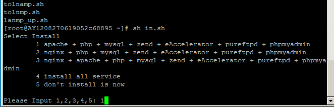

下午又裝了次centos5.432位的~!
只編譯按照了2.4的Apache
QQ登陸依然不行,現(xiàn)在不出現(xiàn)502了。成了324了

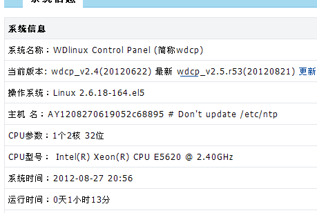

下面是截圖
wdcp版本
apache錯(cuò)誤代碼
老大有時(shí)間了看下~!身心疲憊~!頭大啊~!其他都正常,就QQ登陸不行,微薄登陸現(xiàn)在沒(méi)有問(wèn)題了~!
[Mon Aug 27 20:57:25 2012] [notice] child pid 22817 exit signal Segmentation fault (11)
[Mon Aug 27 20:57:34 2012] [notice] child pid 22819 exit signal Segmentation fault (11)
[Mon Aug 27 20:57:35 2012] [notice] child pid 22815 exit signal Segmentation fault (11)
[Mon Aug 27 20:57:35 2012] [notice] child pid 22818 exit signal Segmentation fault (11)
[Mon Aug 27 20:57:36 2012] [notice] child pid 22807 exit signal Segmentation fault (11)
[Mon Aug 27 20:57:36 2012] [notice] child pid 22816 exit signal Segmentation fault (11)
[Mon Aug 27 20:57:36 2012] [notice] child pid 22820 exit signal Segmentation fault (11)
[Mon Aug 27 20:57:36 2012] [notice] child pid 22821 exit signal Segmentation fault (11)
[Mon Aug 27 20:57:37 2012] [notice] child pid 22880 exit signal Segmentation fault (11)

作者: admin    時(shí)間: 2012-8-28 09:51
從這個(gè)信息看,是內(nèi)核原因或版本編譯原因
作者: itxx    時(shí)間: 2012-8-31 18:14
我看到2.5rc字樣了。。
