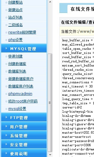

完成數(shù)據(jù)同步,直接在線修改my.cnf。重啟,,記得先在防火墻開對應(yīng)3306端口,,不要告訴我你不知道,,還有個就是,數(shù)據(jù)雙向同步,需做ID的處理,否則將產(chǎn)生ID沖突導(dǎo)致錯誤,這個在這里我就保留一手了,,請見諒。。。。。網(wǎng)上似乎也能找到資料,不過很少很少,,
LINUX---A
server-id=1
log-bin=mysql-bin
binlog-do-db=需數(shù)據(jù)庫
binlog-ignore-db=information_schema
binlog-ignore-db=mysql
binlog-ignore-db=test
master-host=被同步IP
master-user=被同步帳號
master-password=被同步密碼
master-port=3306
replicate-do-db=需數(shù)據(jù)庫
master-connect-retry=60
LINUX---B
server-id=2
log-bin=mysql-bin
master-host=被同步IP
master-user=被同步帳號
master-port=3306

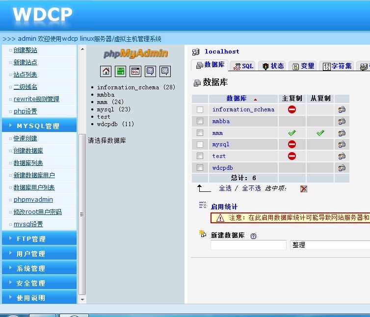

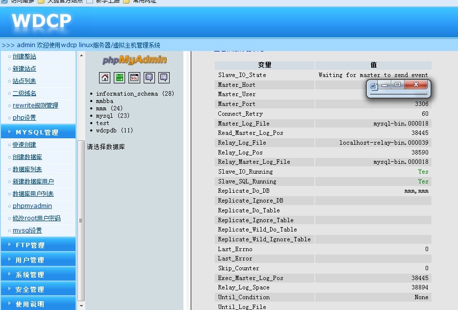

bnbk
時間:
2012-9-23 20:09
(129.66 KB)
2012-9-23 20:07
(108.17 KB)
2012-9-23 20:07
(71.05 KB)
2012-9-23 20:09
完成效果,
