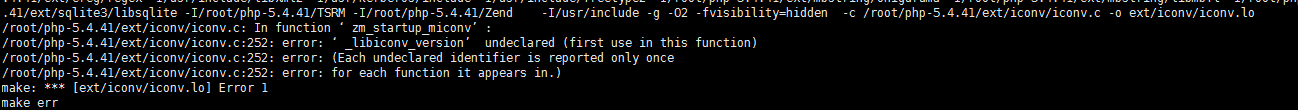

作者: 269406793    時(shí)間: 2015-6-2 23:37     標(biāo)題: PHP5.3 升級(jí) 最新PHP5.4.41 的問題
/root/php-5.4.41/ext/iconv/iconv.c: In function ‘zm_startup_miconv’:
/root/php-5.4.41/ext/iconv/iconv.c:252: error: ‘_libiconv_version’ undeclared (first use in this function)
/root/php-5.4.41/ext/iconv/iconv.c:252: error: (Each undeclared identifier is reported only once
/root/php-5.4.41/ext/iconv/iconv.c:252: error: for each function it appears in.)
make: *** [ext/iconv/iconv.lo] Error 1
make err
圖片附件: IUUX9ASG7YFNKB[2HEX4YP2.png (2015-6-2 23:36, 11.55 KB) / 下載次數(shù) 7414
http://www.szkyjg.com/bbs/attachment.php?aid=5388&k=93f5e211955465c18f428d6743a5f3d8&t=1746207811&sid=cfamec
作者: web58@qq.com    時(shí)間: 2015-6-7 15:53
我也出現(xiàn)和你一樣的情況,摸索了幾天 終于搞定了
如果你的iconv安裝正常的話,你只要把php_up54.sh 里面的--with-iconv=/usr 改成--with-iconv-dir=/usr  有兩處。
