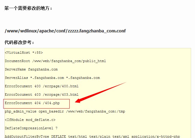

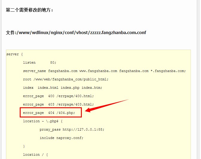

作者: hanfei    時間: 2014-7-11 21:52
圖片附件: 001.jpg (2014-7-11 21:51, 51.57 KB) / 下載次數(shù) 13325
http://www.szkyjg.com/bbs/attachment.php?aid=4672&k=ba262a1681e979bdb6525ff74f1f829a&t=1744254891&sid=w9w2W4
圖片附件: 002.jpg (2014-7-11 21:52, 53.33 KB) / 下載次數(shù) 13313
http://www.szkyjg.com/bbs/attachment.php?aid=4673&k=2b2f6eda56668ae39c64cd19426f577c&t=1744254891&sid=w9w2W4
作者: hanfei    時間: 2014-7-11 21:53
回復(fù) 1# hjc91
圖片附件: 001.jpg (2014-7-11 21:52, 51.57 KB) / 下載次數(shù) 13359
http://www.szkyjg.com/bbs/attachment.php?aid=4674&k=022f193539cd7bd0e10b8727d9b25612&t=1744254891&sid=w9w2W4
圖片附件: 002.jpg (2014-7-11 21:52, 53.33 KB) / 下載次數(shù) 13347
http://www.szkyjg.com/bbs/attachment.php?aid=4675&k=d3d71100570f944bd4fa97eaec48128d&t=1744254891&sid=w9w2W4
