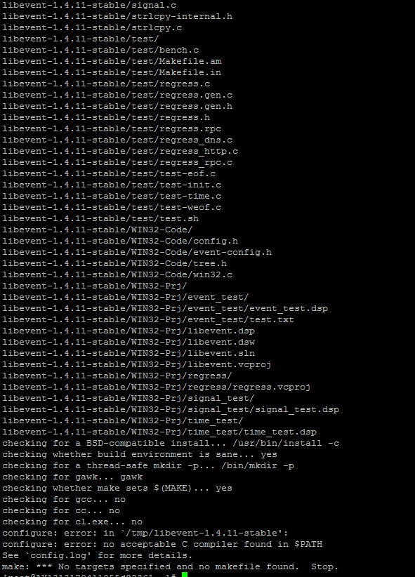

剛剛裝上的WDCP,系統(tǒng)也是新裝的
步驟完全按照這里的
http://www.szkyjg.com/bbs/thread-1373-1-1.html
就是編譯不成功,求解
圖片附件: QQ截圖20121218105928.jpg (2012-12-18 11:02, 195.73 KB) / 下載次數(shù) 13882
http://www.szkyjg.com/bbs/attachment.php?aid=2239&k=b61b74910bf1edfad640c73f020ae16f&t=1746274580&sid=Wu0UDw
作者: admin    時(shí)間: 2012-12-18 13:48
沒(méi)有GCC編譯環(huán)境
yum install -y gcc gcc-c++ make autoconf libtool-ltdl-devel gd-devel freetype-devel libxml2-devel libjpeg-devel libpng-devel openssl-devel curl-devel patch libmcrypt-devel libmhash-devel ncurses-devel sudo bzip2

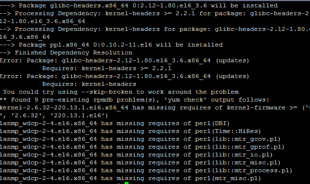

圖片附件: error.png (2012-12-23 23:30, 21.61 KB) / 下載次數(shù) 13384
