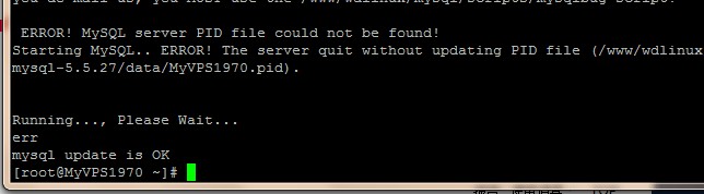

作者: qq682907    時(shí)間: 2013-2-28 23:28     標(biāo)題: mysql升級到5.5報(bào)錯(cuò)了
本帖最后由 qq682907 于 2013-2-28 23:37 編輯
wget http://down.wdlinux.cn/in/mysql_up55.sh
sh mysql_up55.sh我是按著這個(gè)升級的 是面板安裝好后
升級的
詳細(xì)的錯(cuò)誤日志
130228 23:33:43 [Note] Server hostname (bind-address): '0.0.0.0'; port: 3306
130228 23:33:43 [Note]   - '0.0.0.0' resolves to '0.0.0.0';
130228 23:33:43 [Note] Server socket created on IP: '0.0.0.0'.
130228 23:33:43 [ERROR] Fatal error: Can't open and lock privilege tables: Table 'mysql.host' doesn't exist
130228 23:33:43 mysqld_safe mysqld from pid file /www/wdlinux/mysql-5.5.27/data/MyVPS1970.pid ended
圖片附件: QQ截圖20130228232600.jpg (2013-2-28 23:28, 30.33 KB) / 下載次數(shù) 19698
http://www.szkyjg.com/bbs/attachment.php?aid=2481&k=0e0911bebdd1f1f384afd6db45f154b7&t=1746861229&sid=qI5QF2
作者: admin    時(shí)間: 2013-2-28 23:41
你這個(gè)是新下載安裝的嗎?
怎么還是/www/wdlinux/mysql-5.5.27/data目錄,應(yīng)該是
/www/wdlinux/mysql-5.5.27/var
這個(gè)才對的

錯(cuò)誤日志如下,請教如何解決?
130402 20:03:37 mysqld_safe Starting mysqld daemon with databases from /www/wdlinux/mysql-5.5.27/data
/www/wdlinux/mysql-5.5.27/bin/mysqld: Table 'mysql.plugin' doesn't exist
130402 20:03:37 [ERROR] Can't open the mysql.plugin table. Please run mysql_upgrade to create it.
130402 20:03:38 InnoDB: The InnoDB memory heap is disabled
130402 20:03:38 InnoDB: Mutexes and rw_locks use GCC atomic builtins
130402 20:03:38 InnoDB: Compressed tables use zlib 1.2.3
130402 20:03:38 InnoDB: Initializing buffer pool, size = 128.0M
130402 20:03:38 InnoDB: Completed initialization of buffer pool
130402 20:03:38  InnoDB: Operating system error number 13 in a file operation.
InnoDB: The error means mysqld does not have the access rights to
InnoDB: the directory.
InnoDB: File name ./ibdata1
InnoDB: File operation call: 'create'.
InnoDB: Cannot continue operation.
130402 20:03:38 mysqld_safe mysqld from pid file /www/wdlinux/mysql-5.5.27/data/li260-147.pid ended

回復(fù) 14# qq682907
    可以修改下/www/wdlinux/init.d/mysqld這個(gè)文件
    里面這兩行basedir=
                  datadir=
    修改如下
    basedir=/www/wdlinux/mysql
    datadir=/www/wdlinux/mysql/var
    然后再重新試試

修改的是init.d目錄下mysqld這個(gè)文件,寫少了,樓上正解
