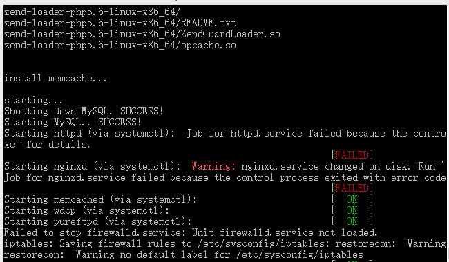

我剛在一臺centos的主機上測試,問題依舊,訪問不了默認目錄
重裝,最后有提醒
Starting nginxd (via systemctl):  Warning: nginxd.service changed on disk. Run 'systemctl daemon-reload' to reload units.
Job for nginxd.service failed because the control process exited with error code. See "systemctl status nginxd.service" and "journalctl -xe" for details.
修改過哪?
重起試試
