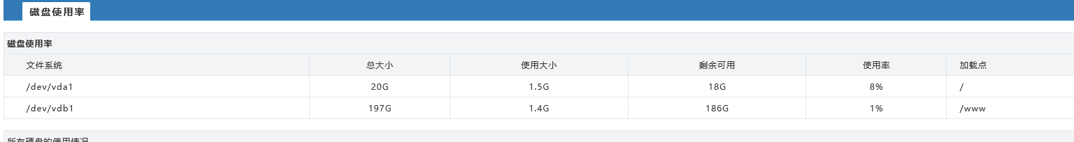

作者: deeboo    時間: 2016-8-13 00:01
圖片附件: aaa.png (2016-8-13 00:01, 14.42 KB) / 下載次數(shù) 12465
http://www.szkyjg.com/bbs/attachment.php?aid=6514&k=136f94fecc9548227515c1afbda57248&t=1746155347&sid=21RAHQ
