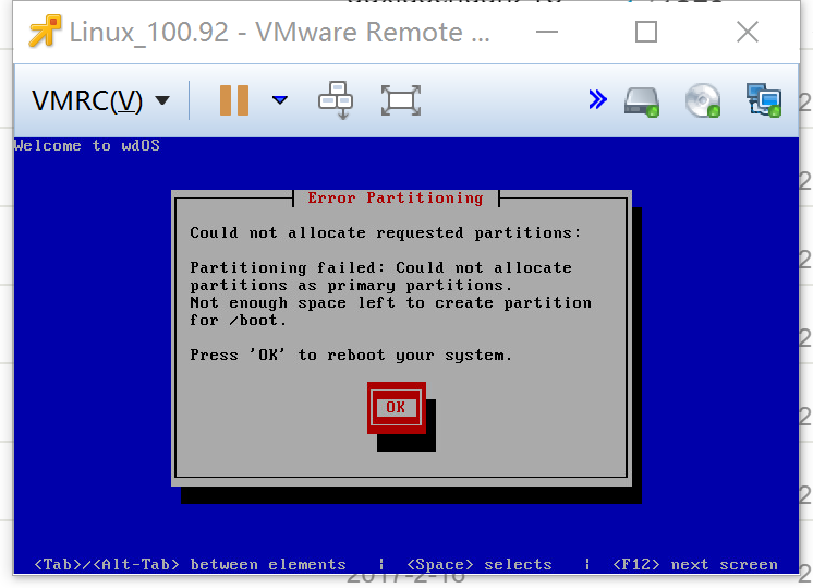

wmware下無(wú)法安裝WDOS
(93.5 KB)
2017-9-8 11:36
(78.78 KB)
2017-9-8 11:36
vsphere 6.5
(2017-9-8 11:36, 78.78 KB) / 下載次數(shù) 7720
http://www.szkyjg.com/bbs/attachment.php?aid=7967&k=658f10295d833ae0f2eb59c3ee9a6a3b&t=1743836576&sid=usUJK0
(2017-9-8 11:36, 93.5 KB) / 下載次數(shù) 7677
http://www.szkyjg.com/bbs/attachment.php?aid=7968&k=4c0d6e3ed89c42479a72d869ae6ee554&t=1743836576&sid=usUJK0

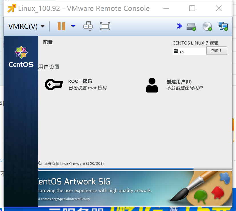

(284.11 KB)
2017-9-8 12:05
centos7可以正常安裝
(2017-9-8 12:05, 284.11 KB) / 下載次數(shù) 7846
http://www.szkyjg.com/bbs/attachment.php?aid=7969&k=636bc9de35756b4b33b6b259f492c2af&t=1743836576&sid=usUJK0

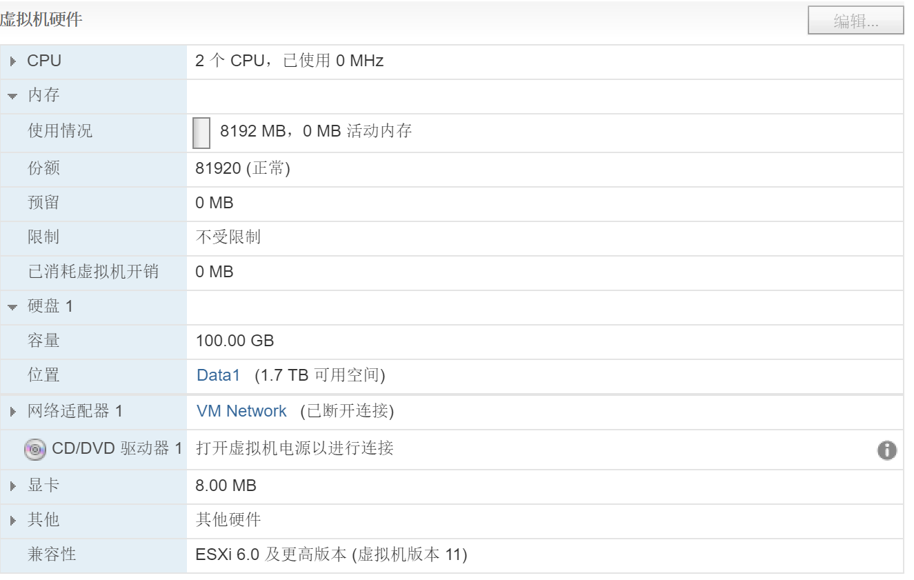

經(jīng)過(guò)不停的測(cè)試,換硬盤(pán),發(fā)現(xiàn)硬盤(pán)模式設(shè)置為sata可以,SCSI不行
