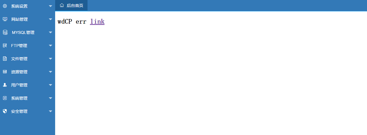

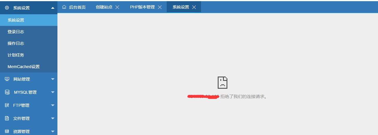

如題:升級至v3.2.18(20171025) 打不開了,提示拒絕鏈接請求,端口號也沒有了,重啟也無效!
CentOS 7.X升級到3.2.18后打不開的修復(fù)辦法:
[root@localhost ~]# sh /www/wdlinux/wdcp/shell/cr7.sh && service wdcp restart
cp: error writing ‘/etc/rc.d/init.d/wdcp’: Permission denied
cp: failed to extend ‘/etc/rc.d/init.d/wdcp’: Permission denie

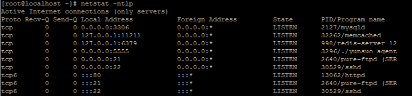

查看端口:
依舊打不開----
