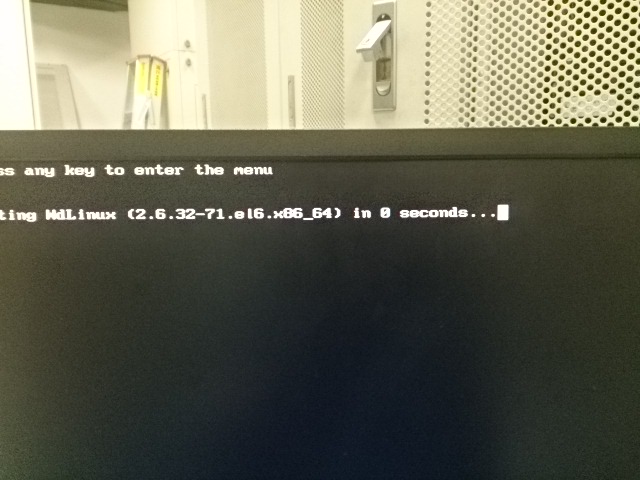

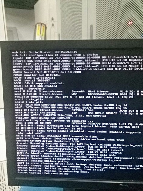

服務(wù)器資料:
服務(wù)器 ibm x3550
RAID1 模式

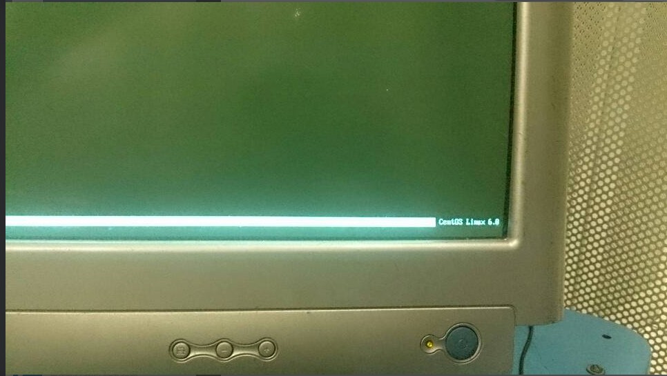

狀況:網(wǎng)站無法上傳圖片,命令無法重啟系統(tǒng),于是硬重啟和斷電重啟,現(xiàn)在無法進入系統(tǒng),卡在進度條?看下圖
(47.03 KB)
2013-10-24 22:29
到這就就沒動靜了。

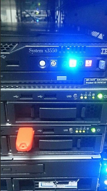

補充:一個硬盤長亮,另一個閃爍,都是綠燈

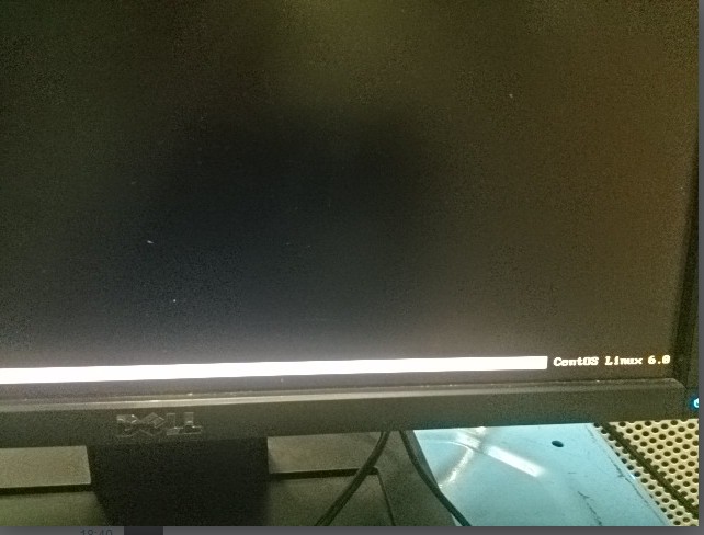

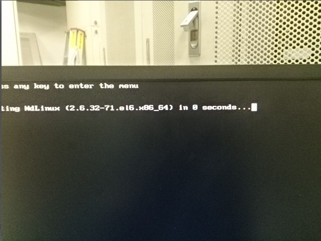

后來,進度條讀完,出來這個界面
(73.98 KB)
2013-10-24 22:33
全白了,后面就沒反應(yīng)了
(2013-10-24 22:33, 73.98 KB) / 下載次數(shù) 6842
http://www.szkyjg.com/bbs/attachment.php?aid=3789&k=60c7f5c0da8b6872f2a913a968d725d9&t=1743816858&sid=XUjsXk
bingsheng868
時間:
2013-10-24 22:36
按任意鍵,無法進入

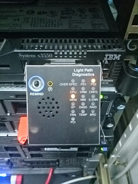

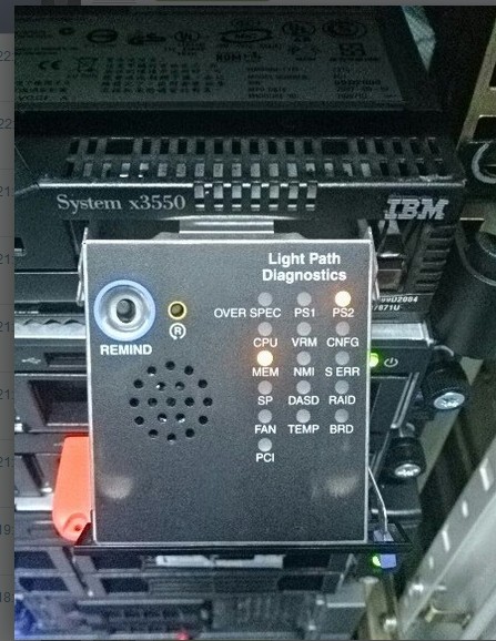

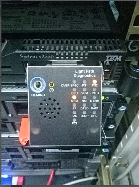

IBM 檢測卡指示燈情況
(100.08 KB)
2013-10-24 22:42
(2013-10-24 22:42, 100.08 KB) / 下載次數(shù) 6863
http://www.szkyjg.com/bbs/attachment.php?aid=3790&k=b668b80fb385499f79403e3e641f25c7&t=1743816858&sid=XUjsXk
zhanjun
時間:
2013-10-24 22:45
剛才在QQ看了你發(fā)的IBM服務(wù)器檢查卡的照片MEM燈亮著,內(nèi)存問題!

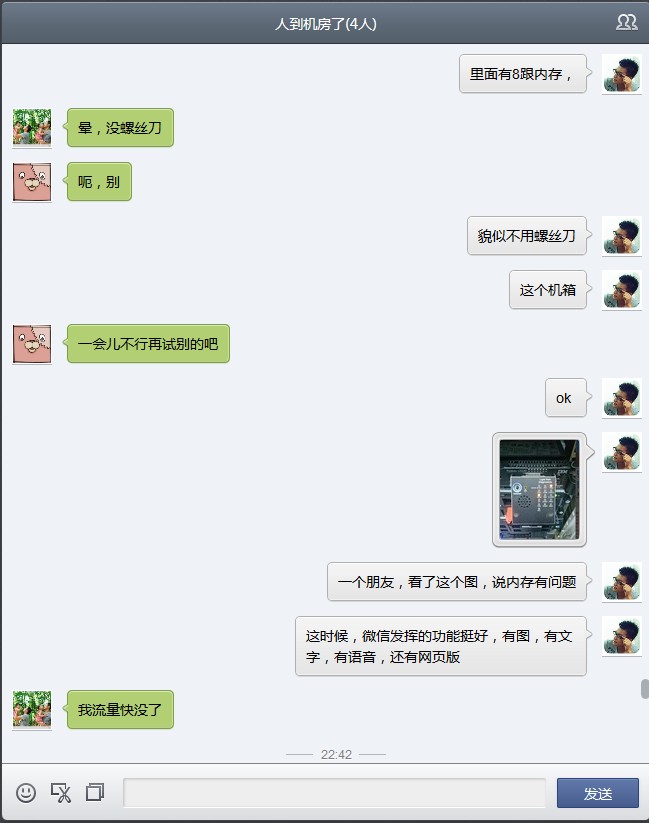

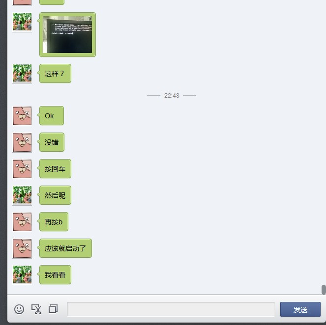

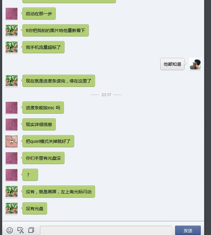

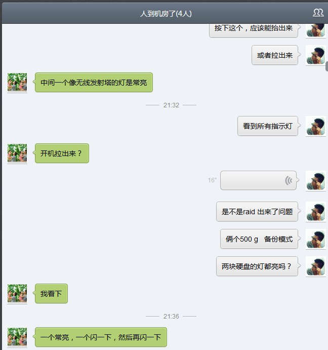

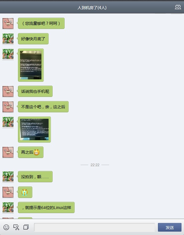

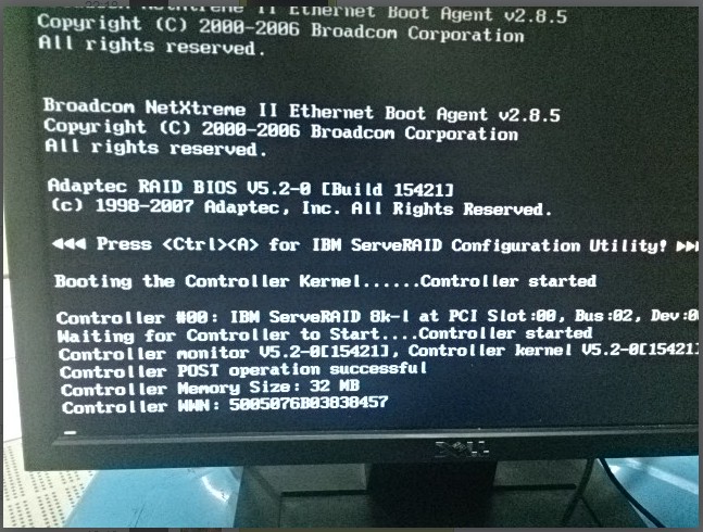

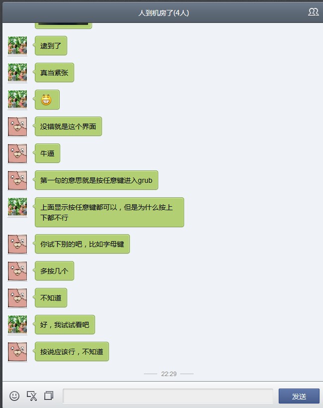

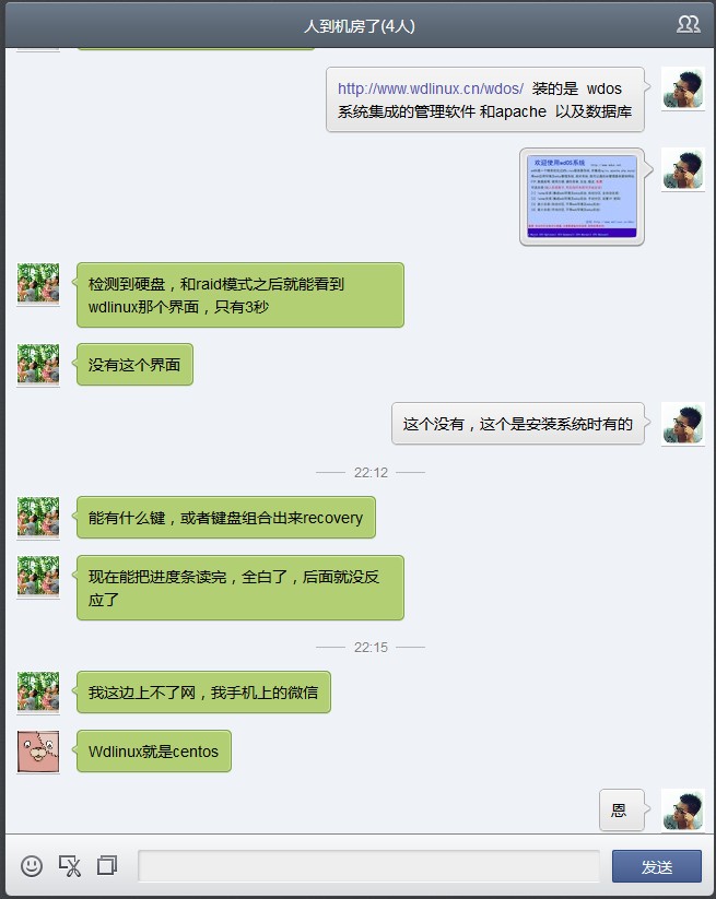

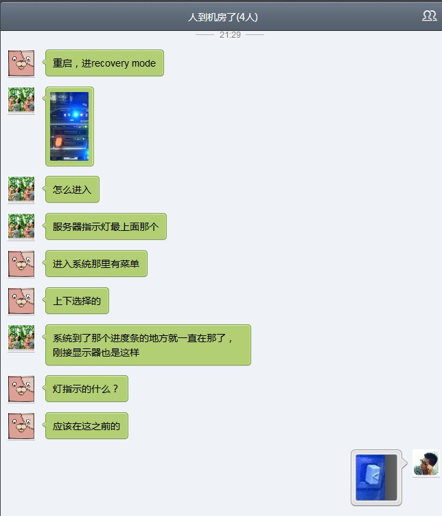

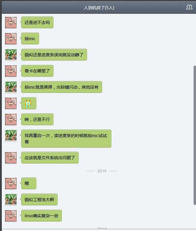

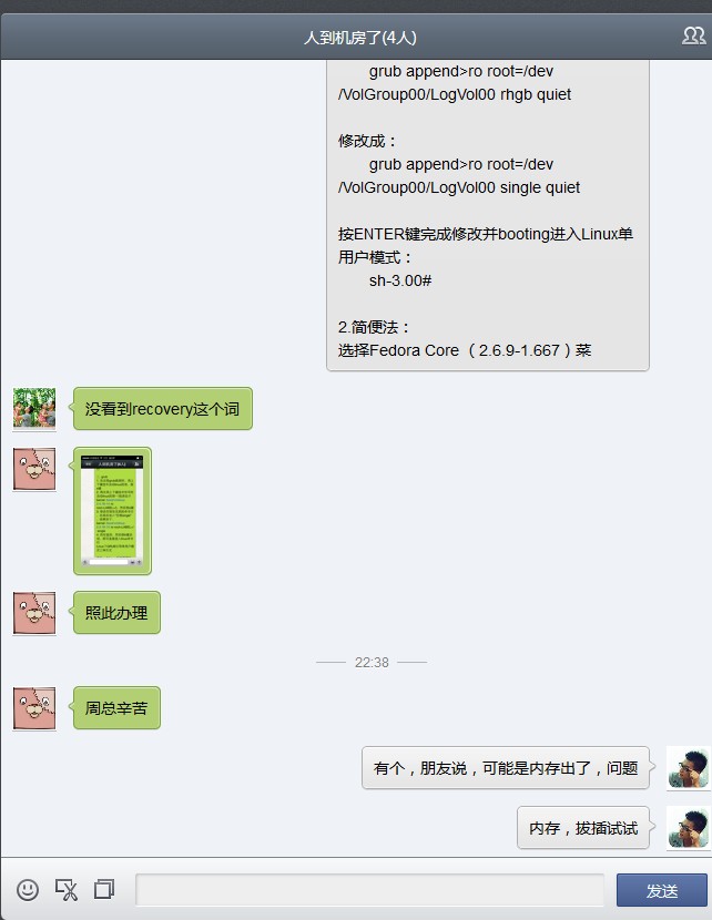

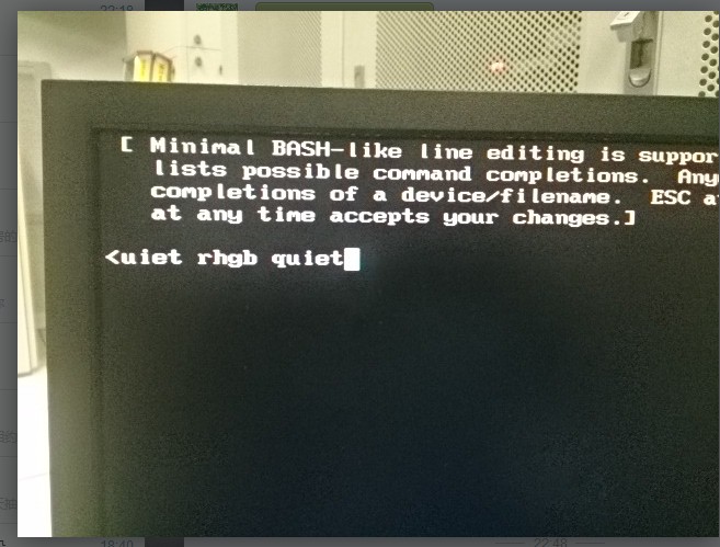

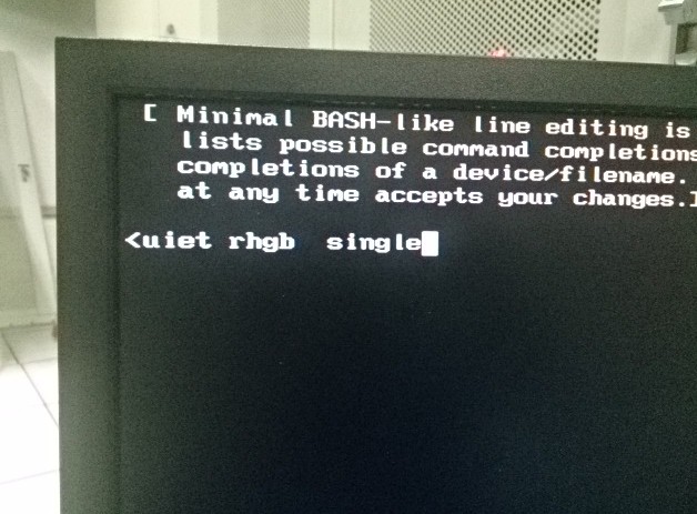

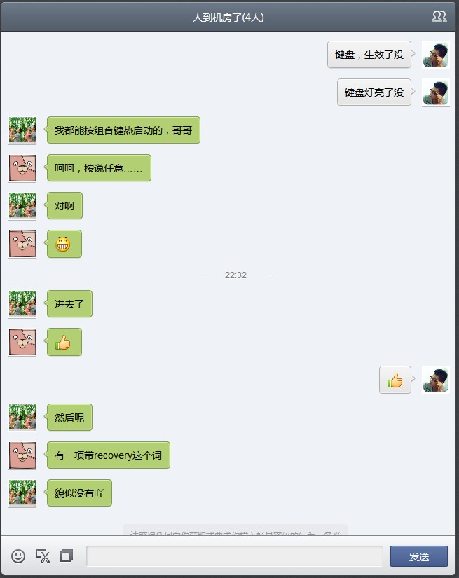

最新情況,所有微信聊天,圖片如下:

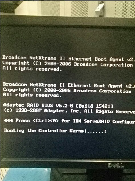

bingsheng868

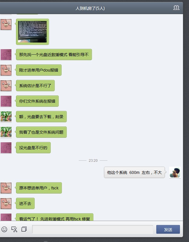

bingsheng868
時間:
2013-10-24 23:21
(67.04 KB)
2013-10-24 23:21
(58.89 KB)
2013-10-24 23:21
(2013-10-24 23:21, 67.04 KB) / 下載次數(shù) 6721
http://www.szkyjg.com/bbs/attachment.php?aid=3827&k=3d4fd653c45a246bc8f08cc97ce5f76a&t=1743816858&sid=XUjsXk
(2013-10-24 23:21, 58.89 KB) / 下載次數(shù) 6784
http://www.szkyjg.com/bbs/attachment.php?aid=3828&k=20926c3fcc57a0fb1d249baac922bd81&t=1743816858&sid=XUjsXk

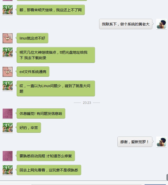

bingsheng868
時間:
2013-10-24 23:31
(79.88 KB)
2013-10-24 23:31
(67.53 KB)
2013-10-24 23:31
(2013-10-24 23:31, 79.88 KB) / 下載次數(shù) 6756
http://www.szkyjg.com/bbs/attachment.php?aid=3830&k=82f1878ea0b54c92a6e581d66267d429&t=1743816858&sid=XUjsXk
(2013-10-24 23:31, 67.53 KB) / 下載次數(shù) 6714
http://www.szkyjg.com/bbs/attachment.php?aid=3831&k=2648f9984ed72b36f99dc8d1c81a2d87&t=1743816858&sid=XUjsXk
