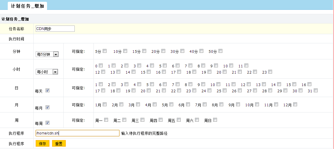

作者: happyxinqiang    時(shí)間: 2013-12-4 10:20
文件權(quán)限也應(yīng)該沒問題~
圖片附件: 12.png (2013-12-4 10:18, 18.92 KB) / 下載次數(shù) 6707
http://www.szkyjg.com/bbs/attachment.php?aid=3941&k=649b9dd66663405b85ffd206f2eafa05&t=1743839291&sid=Kdclkf
圖片附件: 12.png (2013-12-4 10:20, 2.46 KB) / 下載次數(shù) 6689
http://www.szkyjg.com/bbs/attachment.php?aid=3942&k=7d3ab2229fa27476adcf38366dc94ca8&t=1743839291&sid=Kdclkf
作者: admin    時(shí)間: 2013-12-5 09:09
權(quán)限修改為755試試
