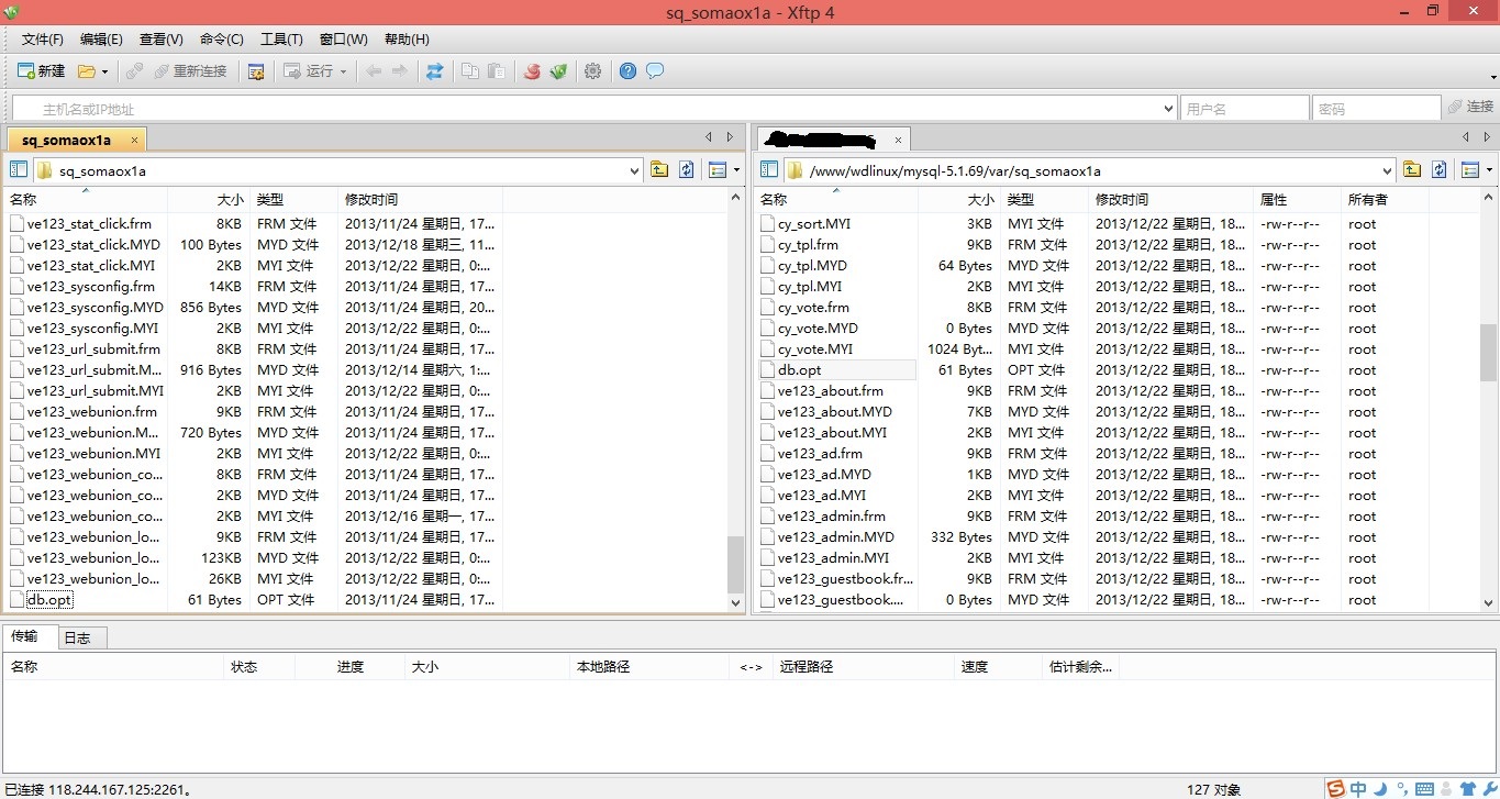

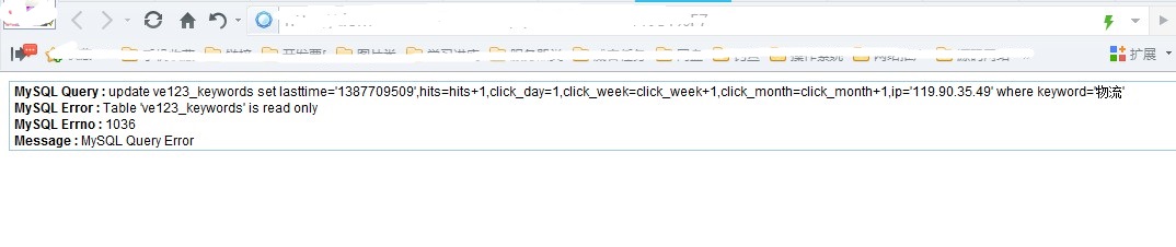

TҵIJϵy(tng) centos5.6汾   ʹwdһIr(sh)  ڂ(g)ԭ wd܉ˣҰѾW(wng)վ͔(sh)(j)(k)(li)°bһwdҲõ nginx+apacheģʽģҰт(li)Ĕ(sh)(j)(k)ς֮ǰһģһӵĔ(sh)(j)(k)Ŀע⣬ςֻǔ(sh)(j)(k)ıĿ䛣L(wn)W(wng)վ  (sh)(j)(k)e(cu)֪զ£ǔ(sh)(j)(k)ę(qun)ކ(wn)}߀ʲôՈ(qng)ToQD
DƬ: 1.jpg (2013-12-22 19:07, 345.45 KB) / dΔ(sh) 9360

DƬ: 2.jpg (2013-12-22 19:08, 50.59 KB) / dΔ(sh) 8936

: admin    r(sh)g: 2013-12-23 09:42
ԓĿˆ(zh)
chown mysql.mysql *
