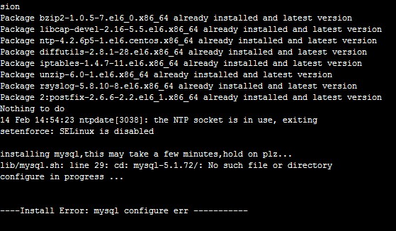

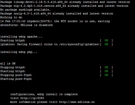

今天剛裝就出現(xiàn)這個問題,小白不懂,下步怎么辦,重裝嗎

lib/mysql.sh: line 29: cd: mysql-5.1.72/: No such file or directory
是不是這個文件有問題啊,好像沒找到一樣

tar: mysql-5.1.72.tar.gz: Cannot open: No such file or directory
tar: Error is not recoverable: exiting now
lib/mysql.sh: line 32: ./configure: No such file or directory
這個是日志,剛重裝又是上面的問題,實(shí)在不懂那出問題了
